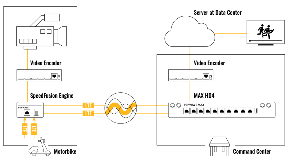

Thus, CYN Communication deployed a SpeedFusion Engine on each vehicle and a MAX HD4 at the command center near the finish line.
using easy setups to broadcasting a sports event smoothly
To be specific, every motorbike driver only needed to carry a backpack housing a SpeedFusion Engine, an antenna kit, a battery, and a video encoder, which was connected to the camera. Each SpeedFusion Engine could form a SpeedFusion Tunnel with the MAX HD4, enabling the implementation of the SpeedFusion technologies, such as Bandwidth Bonding and WAN Smoothing. These technologies can help avoid jitter and latency.
Once the recording started, the live video data would come into SpeedFusion Engine from the video encoder, and subsequently, go to the HD4 router through SpeedFusion Tunnel. Once the data arrived, the HD4 router would relay the live video to online viewers via their processing server located at the data center. Audiences around the world could then know what was happening along the route from any angle.
Peplink Going for Gold
The SpeedFusion Engine is a portable dual-cellular device. It can easily add cellular bonding capabilities to different setups. Together with the HD4, the multi-cellular router deployed at the command center, they aggregated two cellular WANs into one and ensured reliable connectivity. Bandwidth Bonding, one of Peplink’s patented technologies, made it possible for a large amount of data to be transferred and received in real-time.
In addition to the cellular bonding technology, WAN Smoothing also played an important role. It made sure the streams delivered back to the command center were smooth and jitter-free. This technology was used to duplicate actual packets for filling in connectivity gaps so that it could minimize latency and reduce the impact of packet loss.
