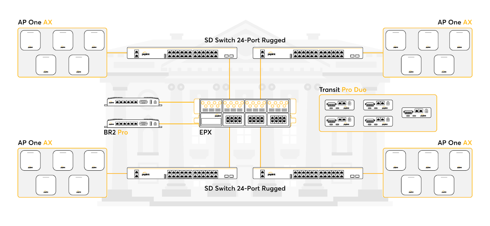

Designed to handle high network traffic, an EPX was installed as the core of the solution in the old English building. Dual BR2 Pros were then added for cellular connectivity. The EPX provided the Peplink partner with the flexibility to connect a 1GB fiber line while utilizing cellular services. Diverse routes were established for fiber optic cables to provide redundancy should a pathway or system unexpectedly fail.
Several 24-port SD Switches were connected to the EPX at St George’s Hall, with up to 20 AP One AXs attached and placed along each side of the building. This placement ensured there was no dead zone in the main room where the meeting was to take place, as well as create independent systems. To monitor the network, the Peplink partner set up battery-powered Transit Duo Pros and enabled InControl’s Air Monitor feature.
The configuration provided the Peplink partner with the means to monitor the network in the old English building, providing reports on the connectivity at key locations. The fiber connection offered guests with ample high-speed connectivity, while the cellular connections were on standby for backup.
During the event, one of the physical cables was accidentally damaged, breaking one of the lines of access points. However, with the independent systems in place, the overall Wi-Fi connectivity remained uninterrupted throughout the meeting.
