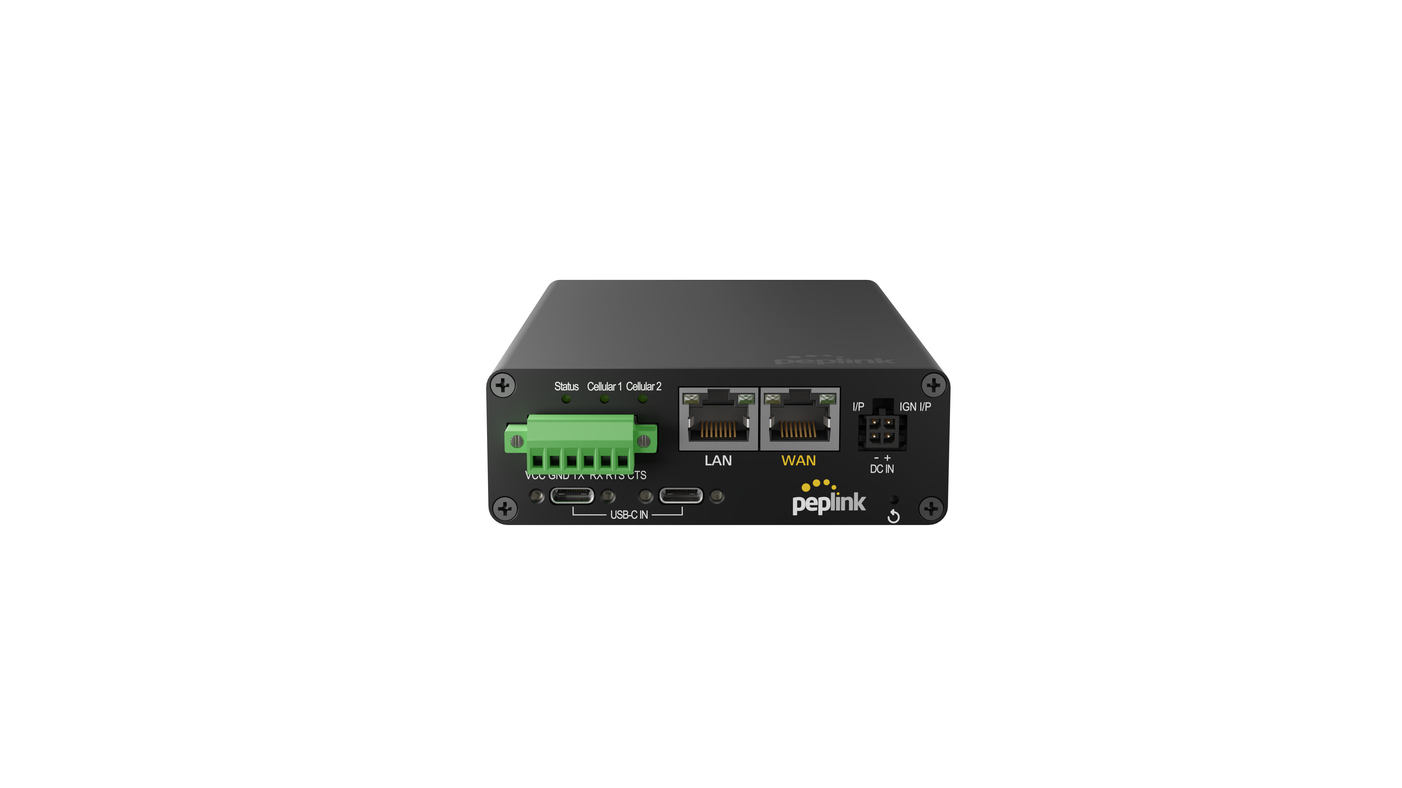

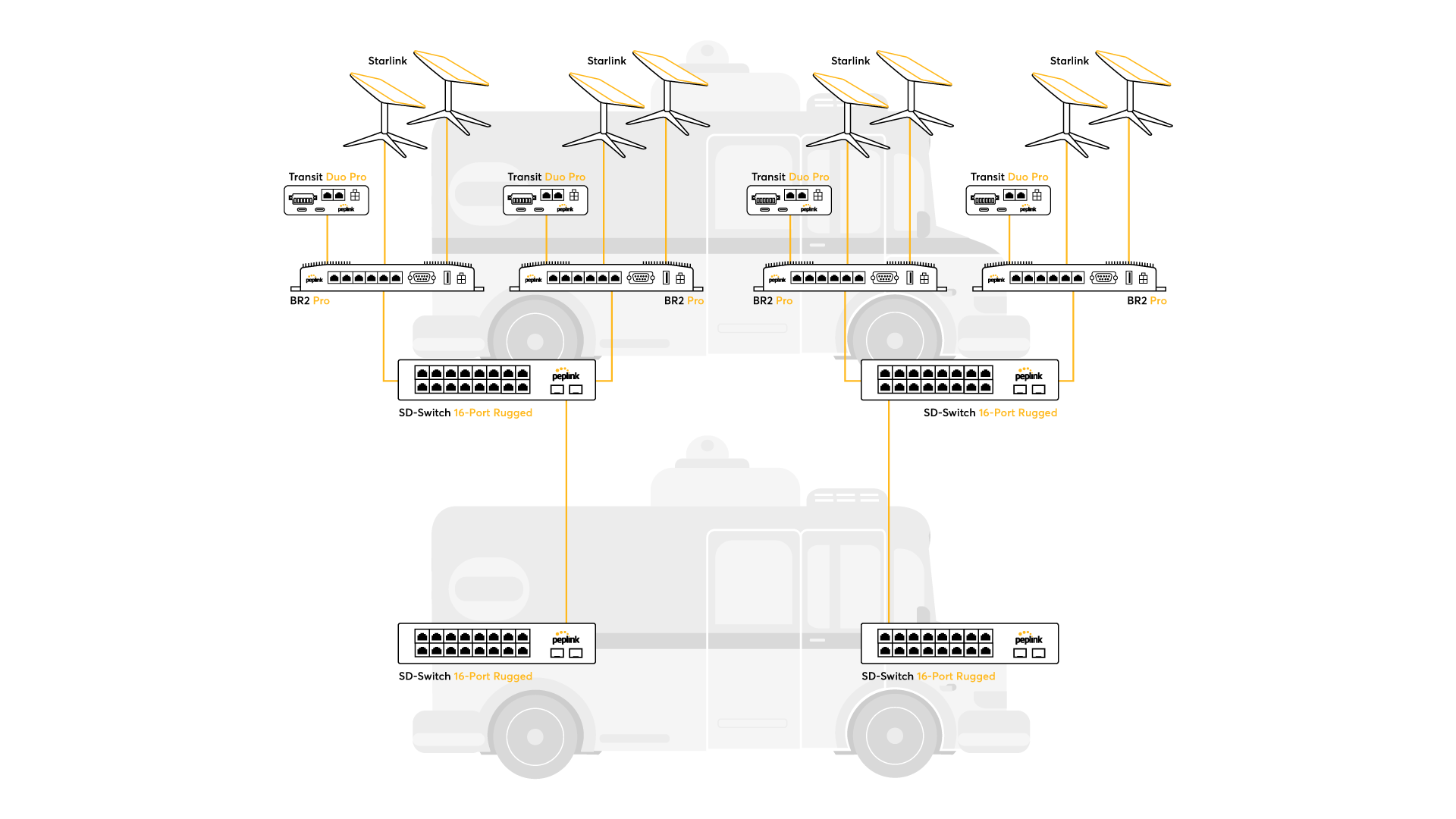

The Peplink partner first designed a complete Peplink ecosystem for the event. They began by setting up a connectivity solution for the streams in the communications trailer. For each stream channel and its backup, they connected a BR2 Pro router to two Starlink antennas and a Transit Duo Pro, which was configured in Synergy Mode to utilize 5G, 4G, and satellite connectivity. This setup established 8 SpeedFusion tunnels, one for each stream.
Two SD Switch 16-Port Rugged devices were connected to each of the two BR2 Pro routers to deliver connectivity to other wired peripherals. These switches were also linked back to the broadcast vehicle, with each switch connected to another SD Switch 16-Port Rugged via a fiber link.

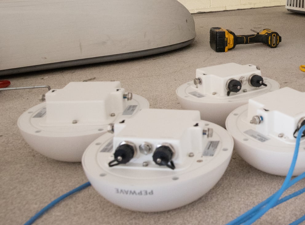

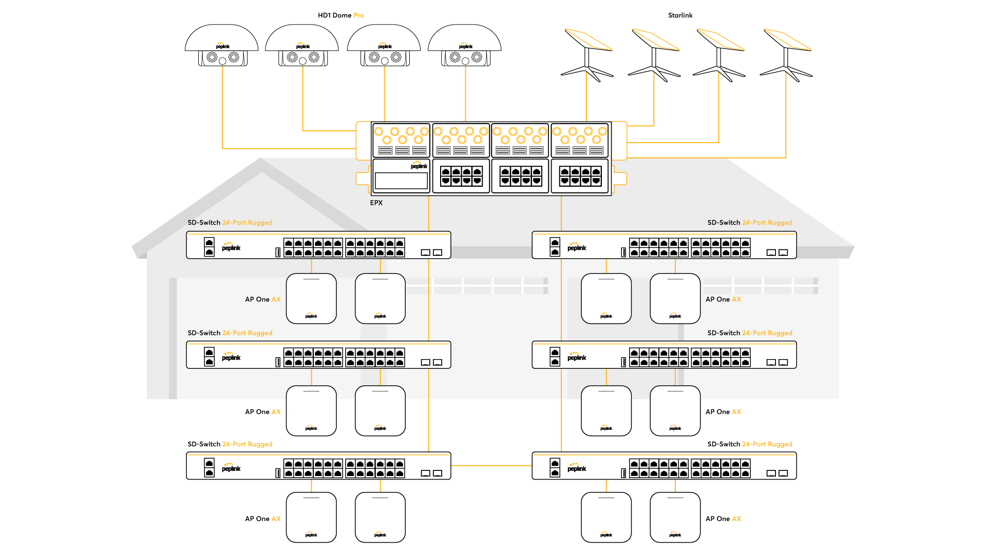

For production and guest Wi-Fi, an EPX equipped with six 5G connections was set up. Additionally, four Starlink dishes and four HD1 Dome Pros were mounted and connected to the EPX. For redundancy and coverage, six SD Switch 24-Port Rugged devices were configured in a fiber ring topology via fiber cables. Multiple AP One AXs were then connected as needed.

- Dual 5G modems installed in the communications trailer
- Connected to Starlink for multiple WAN options
- Enables Smoothing technology for jitterless streams
- Connected to the BR2 Pro through Synergy Mode
- Enables cellular connectivity for streams
- Compact form-factor for portability
- Delivers connectivity to peripherals used for streaming
- Features LAN bypass ports for redundancy and flexibility

- Modular device for flexible WAN options
- Load balances the network for optimal performance
- Mounted on the trailer and connected to the EPX
- Integrated 5G modem and embedded cellular antennas
- Ensures finest signal quality with minimal cable lost
- Connected to the EPX
- Configured in a fiber ring topology for backup between switches
- Delivers power and connectivity to AP One AXs
- Attached to the 24-port switches as needed
- Scalable for wider coverage at event venue
- Provides Wi-Fi 6 connectivity
