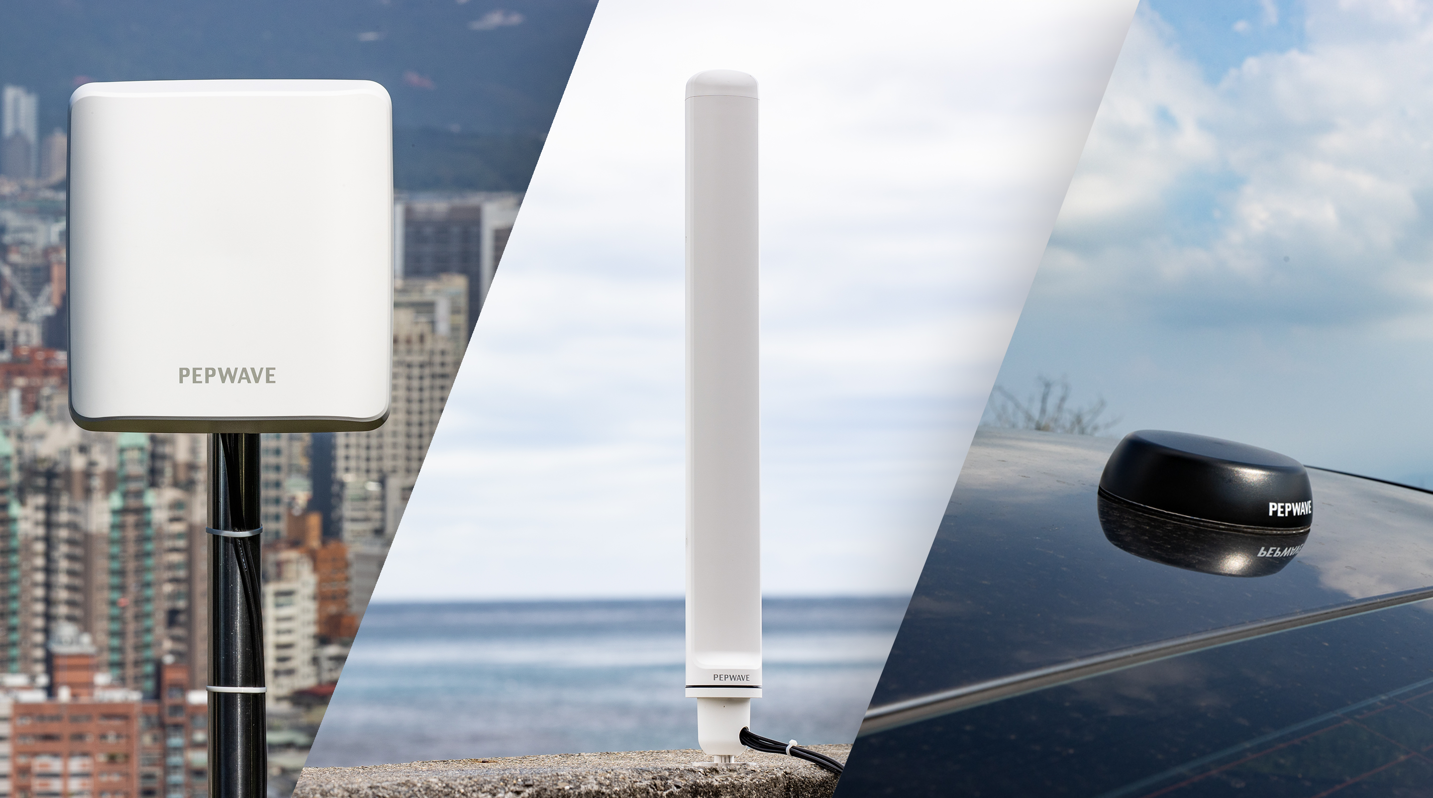

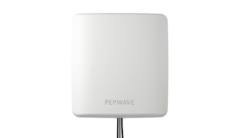

Peplink has launched a series of outdoor antennas tailored to the three most common outdoor uses – transportation, maritime and remote access. These antennas can safeguard excellent signal reception even when they are on the road, on the sea, or in rural areas.
Peplink Outdoor Antenna Series

Make the Most of the Antenna
Even for a good antenna, how to use it makes a difference.
In general, antennas receive electromagnetic waves, turn them into electrical signals, and then transfer the signals to the router via cables. During this process, the signal will unavoidably weaken, also known as attenuation. The longer the cable is, the higher the attenuation will be.
Therefore, to allow for the best possible performance, it is recommended that the antenna stays as close as possible to the router.
If an extension cable is needed, then an LMR-200 or an LMR-400 can be a choice.

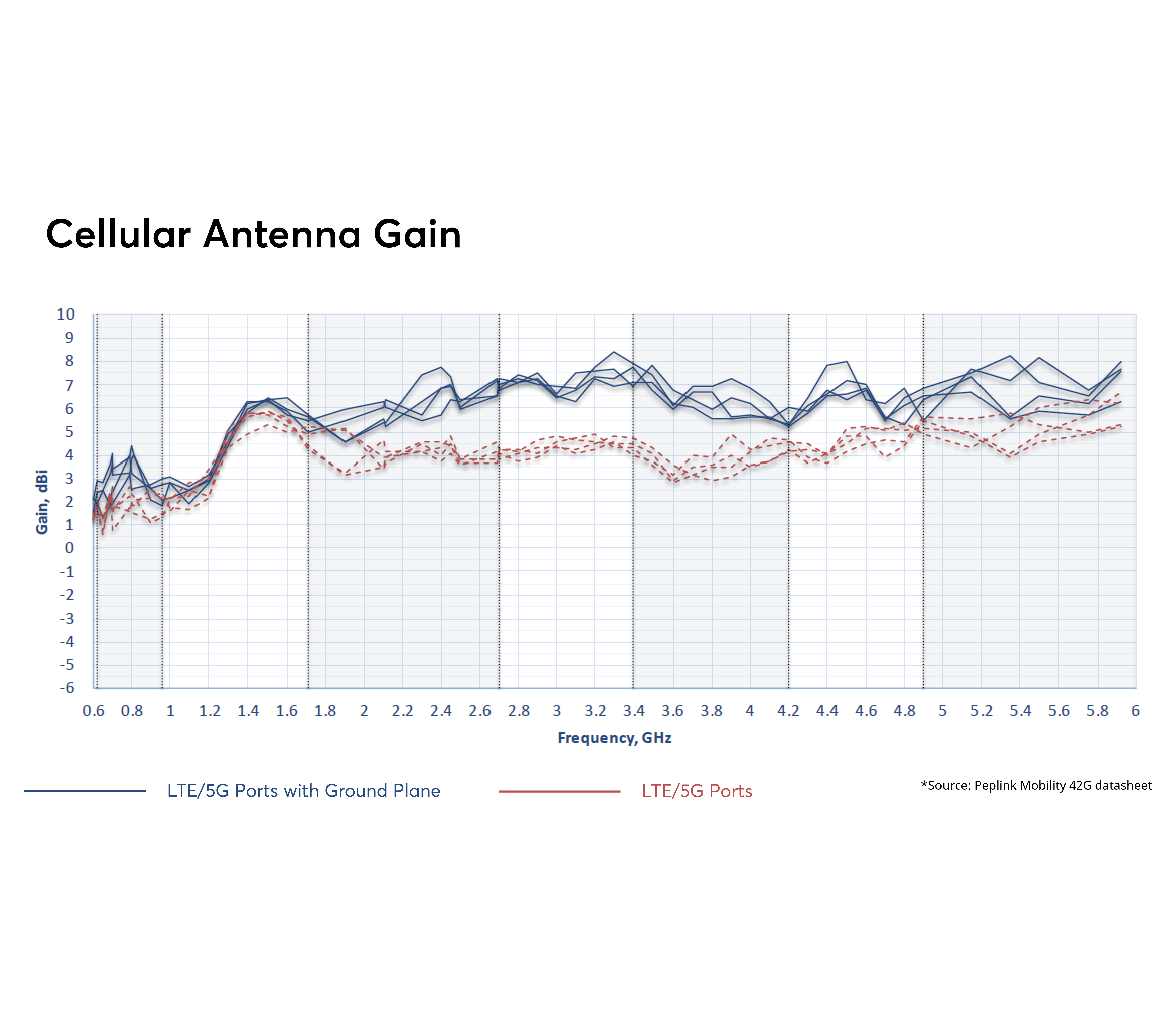

An Extra Ground Plane?
Not Necessary
Using an extra ground plane is definitely optional, but not a must.
Ground planes are like reflectors, enabling signals to be reflected off its surface. Sometimes, people use them to direct radio frequency signals towards their antennas and enhance signal reception.
But if the antenna is good enough, there will not be a big difference between the performance with or without a ground plane. Let’s take Peplink’s latest outdoor antenna as an example.
Here is a comparison of the performance of Mobility 42G when it is used with and without a 60x60cm aluminum ground plane.
